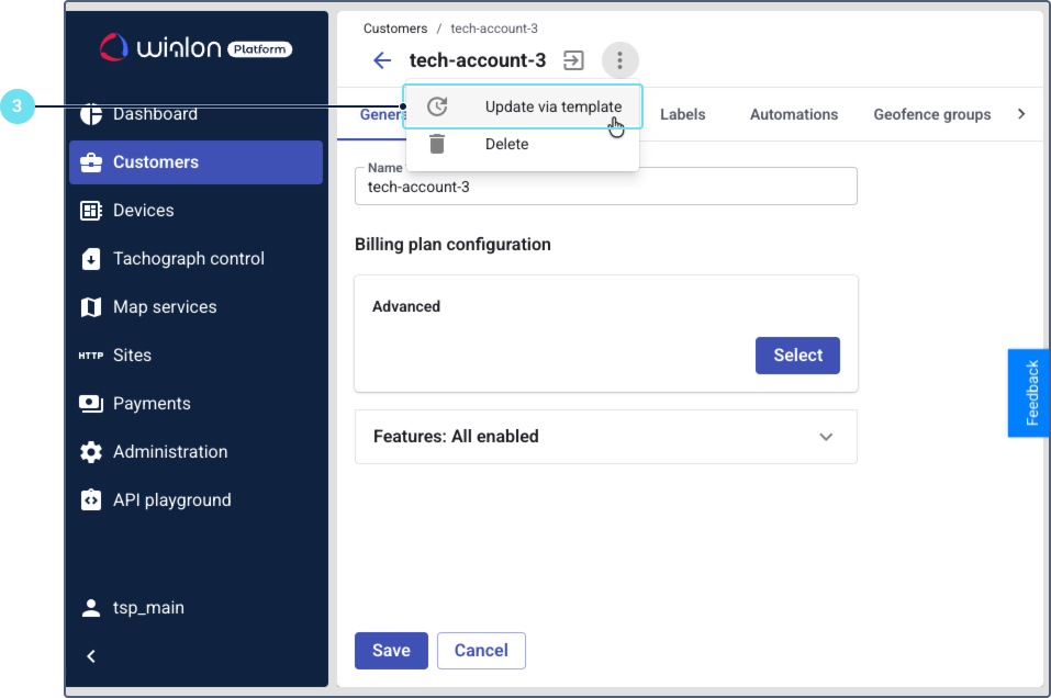

  1. In the navigation menu, go to the Customers page.
  2. Select the customer account you want to update.
  3. Click on the icon three dots icon in the customer row and select the Update via template action.

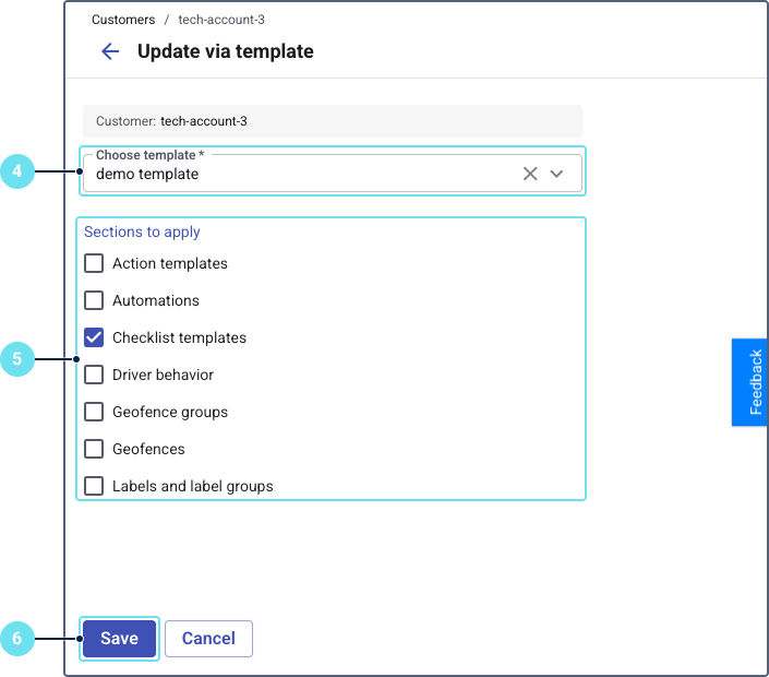

  4. Select the template you want to apply from the available list.
  5. Define the entities types you want to add to the customer account from the template:
  6. Click Save to confirm the update.
The entities from the template will be added to the customer account from the chosen template. The existing entities in the customer account will remain unchanged.
