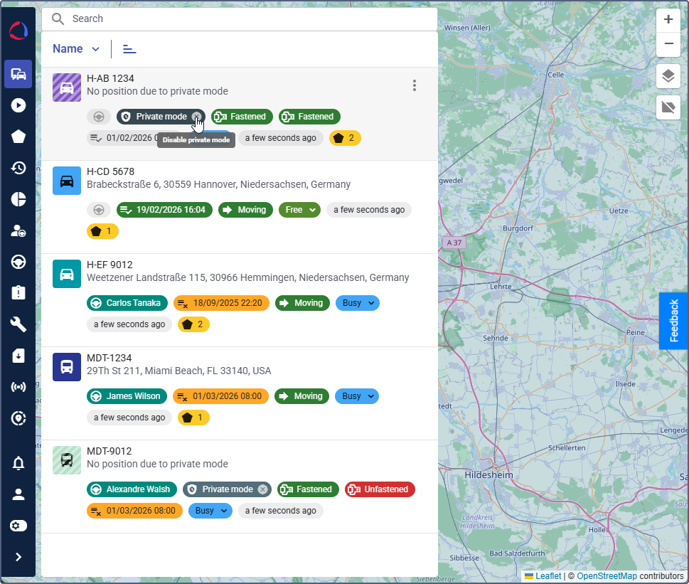

  4. Locate the Manage private use widget or the Private use (chip). The Manage private use widget (indicated with the icon icon of a shield with a clock inside) can be located directly on the list row, inside the menu that opens after clicking on the three dots icon three dots icon, or on the details page. The Private use (chip) can be found on the list row or on the details page.
  5. Click on the Manage private use widget, or click on the icon cross icon of the Private use (chip).

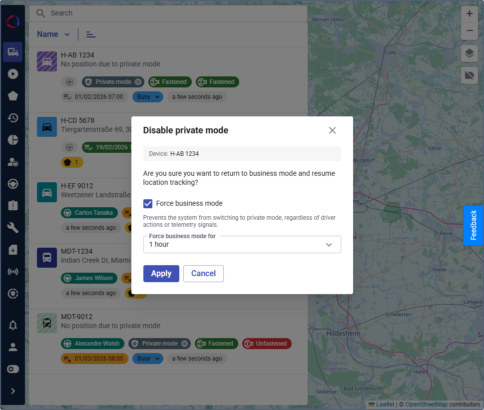

  6. In the opened window, you will have the following options to disable private mode:
    • Click Apply without checking the Force business mode option to simply deactivate private mode.
    • Force business mode: Check this option to forcefully disable private mode. Forced business mode can’t be disabled by the driver from Wialon Driver, nor can it be overridden by automations or parameters sent by the device. If you select this, you can also specify a duration for which the device will remain in business mode. In case if forced business mode ends before the private mode deactivation, the private mode will not be turned on again. Click Apply.
As a result, all effects of private mode activation are cancelled.
