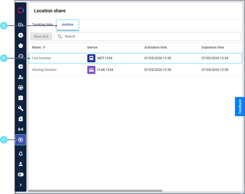

  1. In Wialon Platform FleetSpace, select the Location share page in the sidebar.
  2. Open the Archive tab.
  3. Find the required link in the list. You can use search by link name or vehicle name.

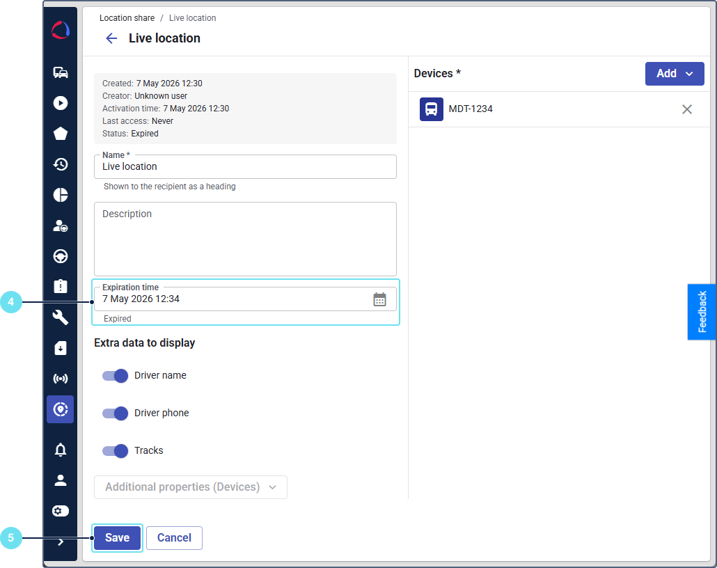

  4. In the Expiration time field, set a future date and time when the reactivated link should expire.
  5. Click Save.
After that, the reactivated link disappears from the archive and becomes available on the Tracking links tab.
