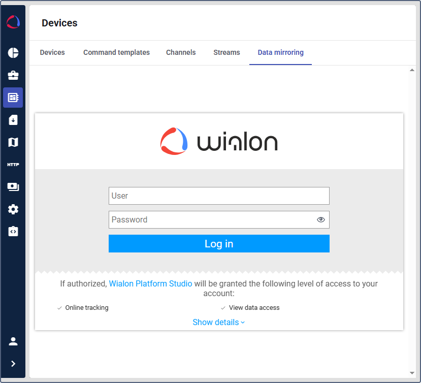

  1. In Wialon Platform Studio, expand the Connectivity section in the navigation menu.
  2. Open the Data mirroring page.
  3. Log in with the username and password of your Wialon Hosting top account.
