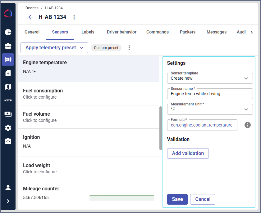

  1. On the Sensors tab in the device properties, select the necessary sensor type.
  2. In the Settings panel, locate the Sensor template field.
  3. Click on the Sensor template field and select Create new.
    create a new sensor template for the engine temperature sensor
  4. In the Sensor name field, enter a descriptive name for your template (for example, Engine temp while driving).
  5. (Optional): In the Measurement unit field, set the unit of measurement (for example, °F).
  6. For the following sensor types: Acceleration, Door open, Engine temperature, Fuel volume, Load weight, Refrigerator temperature, Seatbelt, Tyre pressure, you can add several parameter expressions using the Multiple toggle. For the Engine hours counter and Mileage counter, the Calculation option defines the source of data.
  7. In the Formula field, define the formula to calculate the sensor value from the raw data. For example, use the parameter can.engine.coolant.temperature to see how much heat the engine is producing.
  8. In the Validation section, add a validation condition to ensure the accuracy of the data:
    • In the Type field, select a condition, for example, Parameter is not null to ensure the parameter has some value.
    • In the Parameter name field, indicate the system name of the parameter. For example, position.speed. You can click Add validation to add more conditions.
  9. Click Save to save your new sensor template.
The created template allows displaying the engine temperature when the vehicle is moving with the graph. The template is now stored in these settings and can be applied to other devices.
