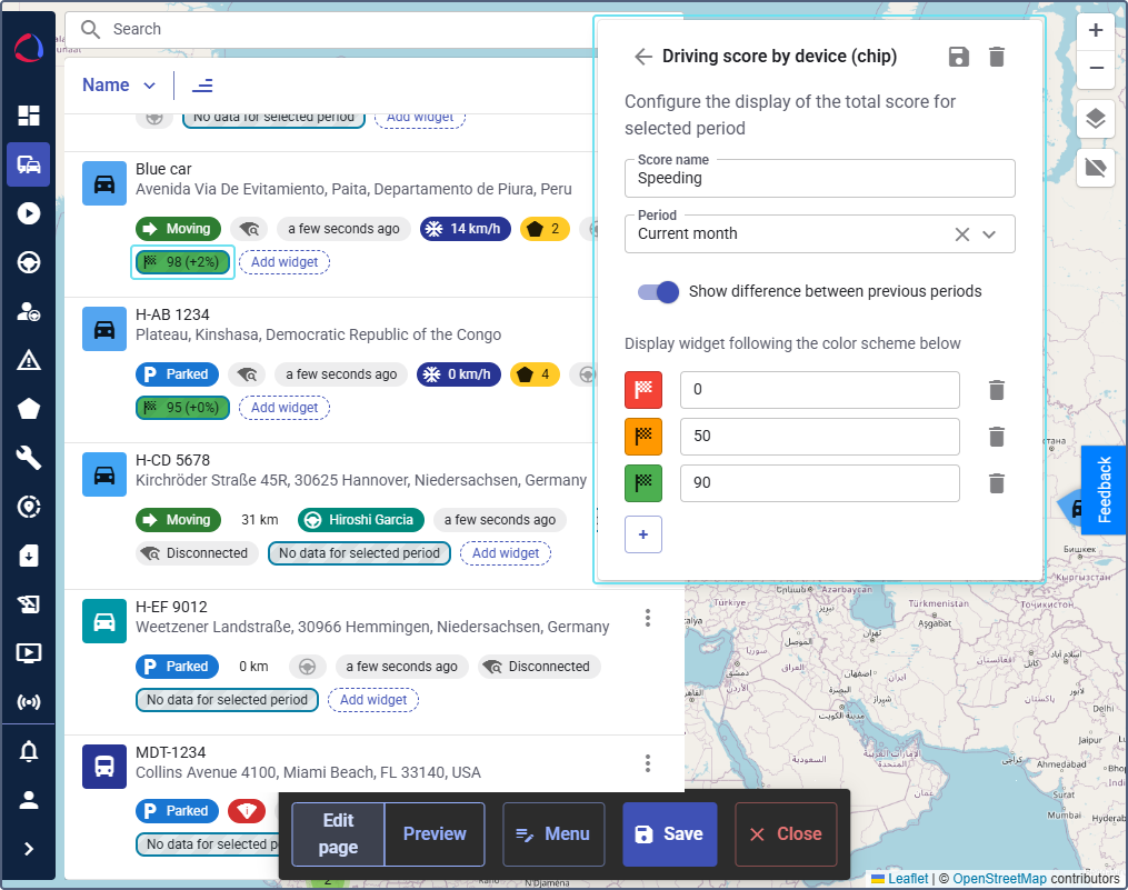

Driving score by device (chip)
The widget displays the total driving score for a selected period. You can compare the score to that of the previous period using the Show difference between previous periods toggle. To add the chip to the device list, follow these steps:
  1. In Wialon Platform FleetSpace, navigate to the Devices page.
  2. Click the icon in the sidebar to enable the editor mode.
  3. Click the Add widget button in any device row.
  4. Click add in the Driving score by device (chip) row. To quickly find the widget, start typing its name in the Search bar.
  5. Enter the Score name.
  6. In the Period field, select the period of the interval: Current month, Current week, or indicate the number of days if the Last days option is selected.
  7. In the Value ranges section, associate colors to the score values. Click add to add a new row to the colors and values scheme. To remove the row, click the icon .
  8. If necessary, turn on the option Show difference between previous periods. The score difference will be displayed as a percentage.

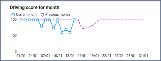

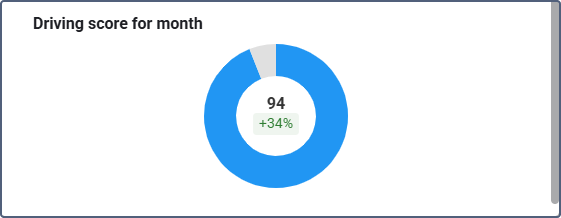

Driving score by device (line or pie chart)
To configure the widget:
  1. In the Title field, enter a name for the widget. For example, Driving score for {{period}}. The value in curly brackets will be replaced by the period you select in the next step.
  2. Select the Period.
  3. Choose the Visualization type: chart or pie.
  4. If necessary, use the toggle Show previous period score.

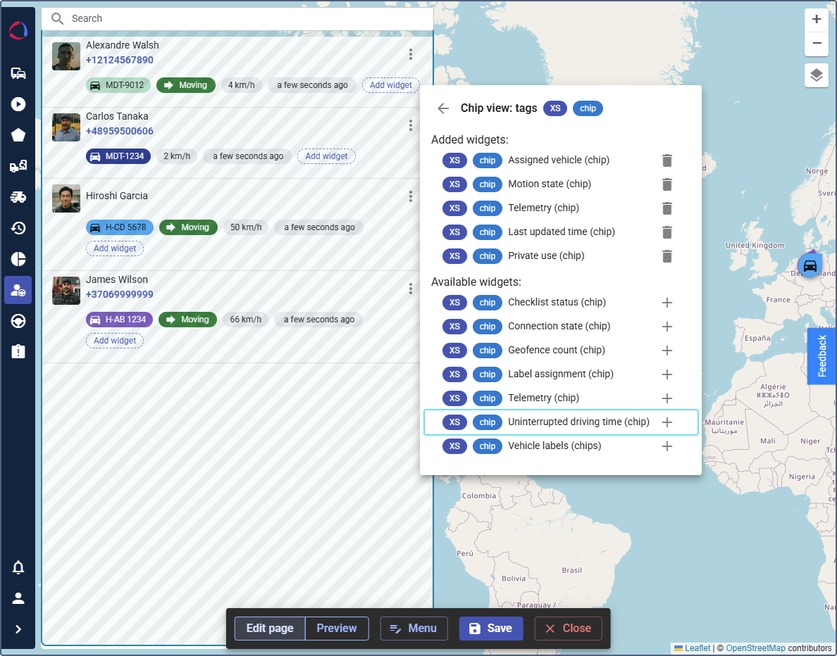

Configuring chips and widgets for the driver details
  1. Click on the driver card in the editor mode to open the Driver card settings.
  2. Under the Chip view section on the top, you can add widgets that appear as chips next to the driver’s name. To find the necessary widget by name, use the Search bar in the widget list.
    • To add a widget: Click the icon add next to the desired widget in the Available widgets list.
    • To remove a widget: Click the icon next to a widget in the Added widgets list.
driver-behavior-widgets
Uninterrupted driving time (chip and cell)
The Uninterrupted driving time widgets display how long a driver has been continuously driving without a parking interval. The widget is available as a chip and as a cell in the driver list and driver details. You can assign icons and colors to time value ranges to visually indicate different driving time states.

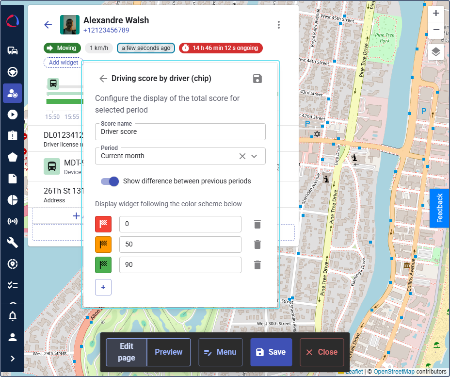

Driving score by driver (chip)
The chip displays the total driving behavior score calculated for all devices driver was assigned to during the selected period. You can compare the score to that of the previous period using the Show difference between previous periods toggle.
To configure the Driving score by driver chip:
  1. Click Add widget in the Chip view section of the device details.
  2. In the Score name field, enter the score name.
    adding-driving-score-chip
  3. In the Period field, select the period of the interval: Current month, Current week, or indicate the number of days if the Last days option is selected.
  4. In the Value ranges section, associate colors to the score values. Click add to add a new row to the colors and values scheme. To remove the row, click the icon .
  5. If necessary, turn on the option Show difference between previous periods.
    driving-score-chip
The added chip shows the driving behavior score for the selected period.

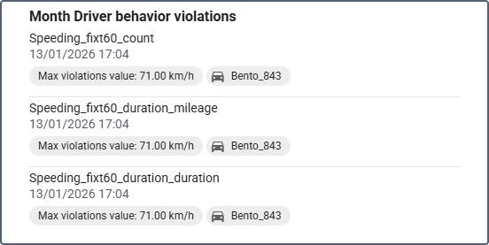

Recent violations by driver (list)
The widget lists 10 most recent violations detected for the driver for all device assignments with indication of the violation parameters and assigned vehicle. The violations are sorted in descending order.
recent-violations
