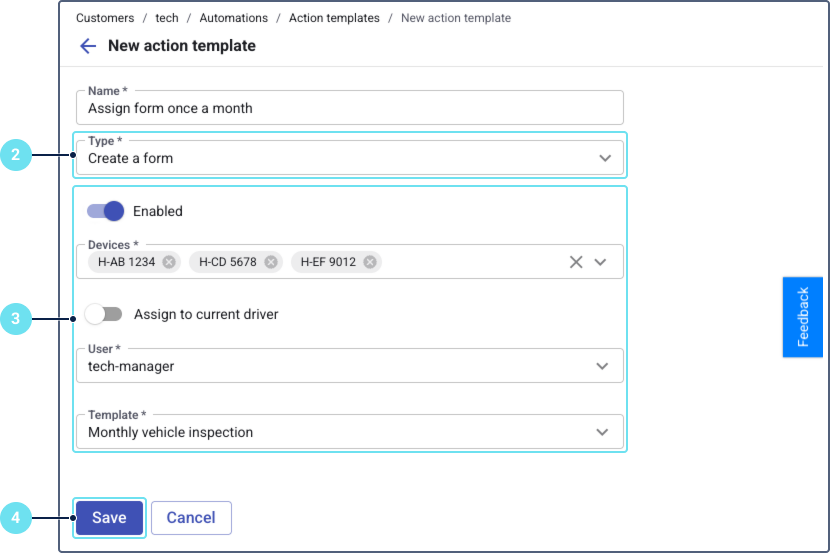

  1. On the Automations tab, select Action templates and click New action.
  2. From the list of action templates, select Create a form.
  3. Configure the following parameters for the Create a form action template:
    • Devices: Select the specific devices to which this form will be assigned.
    • Enabled: Activate the toggle so the action performs if conditions are met.
    • Template: Choose a configured form template that you want to assign. If you haven’t configured the template yet, you can link this automation later while creating the template on the Assignment rules tab.
    • User: Select the user who will be assigned this form. Alternatively, activate the Assign to current driver toggle to assign the form to the driver currently assigned to the device at the moment the automation is activated. When this toggle is active, the user selection becomes unavailable.
  4. Click Save.

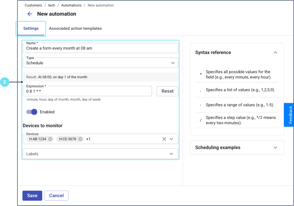

  1. Click New automation to create a new automation.
  2. Configure the following parameters for the new automation:
    • Name: Enter a descriptive name for your automation.
    • Type: In this example, we select the Schedule type, as we want the form to be assigned specific days at specified time.
    • Schedule: For the Schedule type, indicate the formula using Java cron expression. In our example, we use 0 0 9 * * 1-5. That means that the automation activates every working day from Monday to Friday at 9 o’clock.
    • Enabled: Activate the toggle so the automation works if conditions are met.

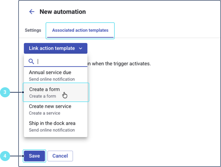

  3. Assign the action template created on Step 2: Creating an action template.
  4. Click Save.
