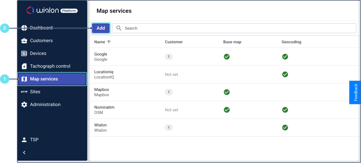

  1. In Wialon Platform Studio, expand the Resources section in the navigation menu and open the Map services page.
    A screenshot of Wialon Platform Studio's 'Map services' screen, showing a list of configured map providers.
  2. Click New map service to open the new map service configuration window.

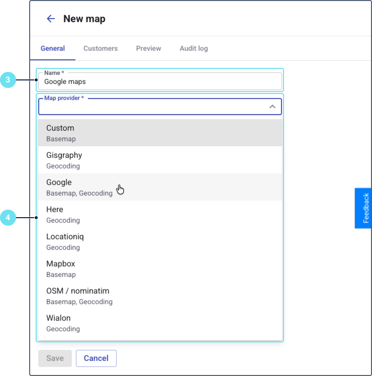

  3. On the General tab, enter the service name. If the service is of the Basemap type and it is enabled for a customer, this name will be visible for the customer in FleetSpace.
    A form for creating a "New map," with the "Map provider" dropdown menu open and the cursor hovering over the "Google" option.
  4. Select a map provider from the drop-down list. Below the provider name, the available services are displayed: Basemap (map tiles), Geocoding (converting coordinates into addresses), or both. The following providers are supported:

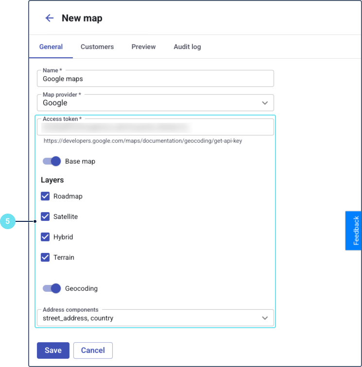

  5. Configure the required parameters such as an access token or API key, visible layers, geocoding, and so on. The settings vary depending on the selected provider. See the Map settings section below for details.
    The "New map" form showing configuration options for Google Maps, including fields for an access token and layer checkboxes.

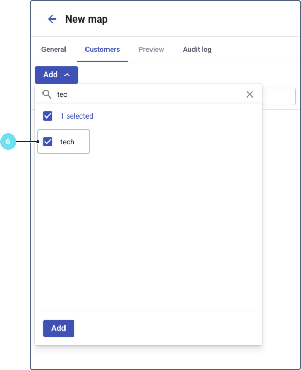

  6. On the Customers tab, assign the map service to one or more customers to make it available in their Wialon Platform FleetSpace interface.
    On the "Customers" tab of the "New map" form, a user is selecting a customer named "tech" from an "Add" search dropdown.

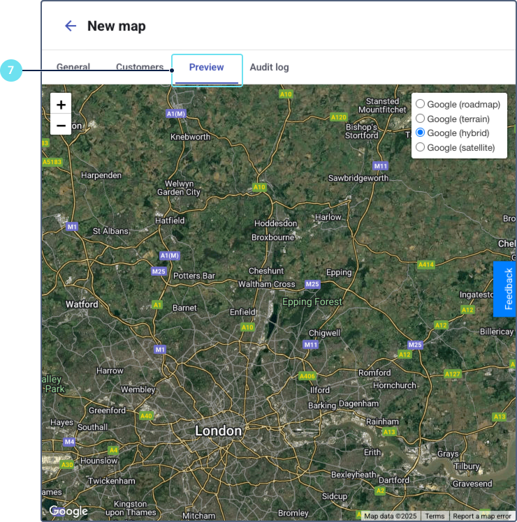

  7. Go to the Preview tab to see how the map will be displayed to the customer. You can pan and zoom to verify that the map tiles and layers load correctly.
    On the "Preview" tab of the "New map" form, a hybrid satellite Google Map of the London area is displayed, with the "hybrid" layer option selected.
