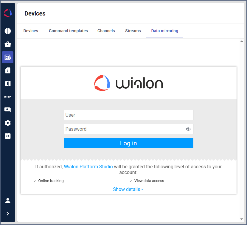

  1. In Wialon Platform Studio, go to the Devices page.
  2. Navigate to the Data mirroring tab.
  3. Log in with the username and password of your Wialon Hosting top account.
