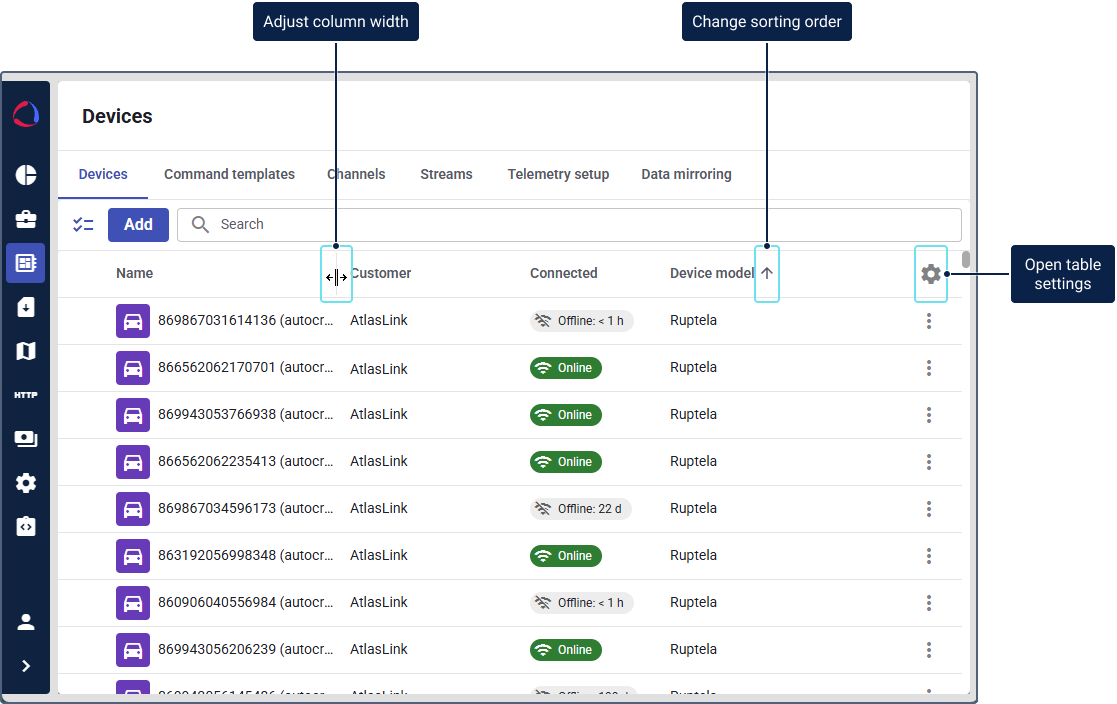

Sorting the table contents
You can sort the devices by any column. To do so, click on the necessary column header. For a descending sorting order, click on the header again.
Adjusting the column width
To adjust the column width, hover over the column header, click its border, then drag and drop it as needed.

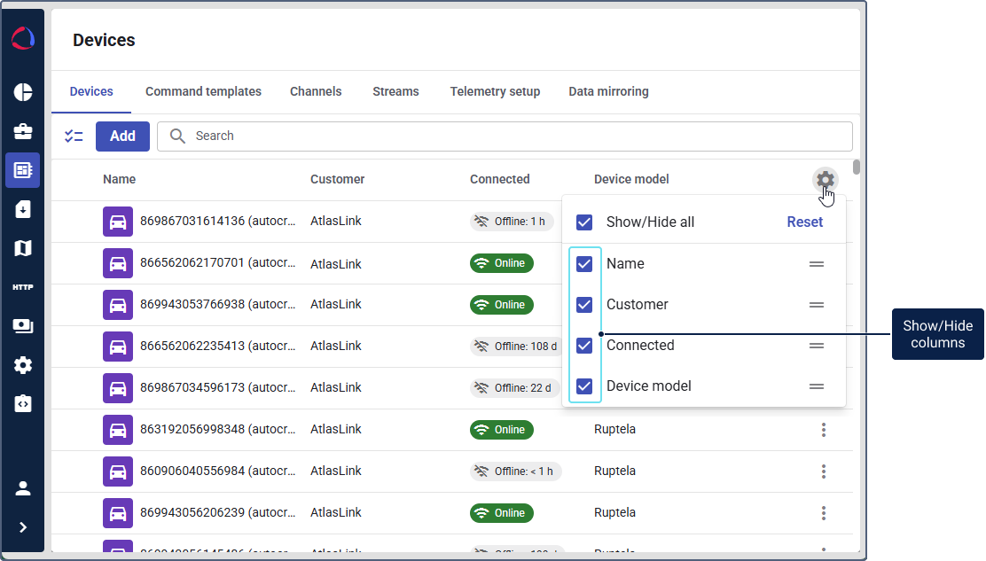

Hiding and showing the columns
To hide the columns you don’t need, click the icon gear icon, and cancel the column selection. To show the column again, select it in the same menu.
To restore the table settings to default, click Reset.

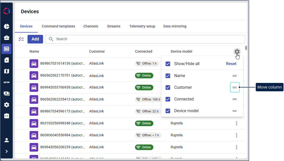

Reordering the columns
To change the order of the table columns:
  1. Click the icon gear icon.
  2. Click the icon opposite the name of the column you want to move.
  3. Drag and drop the column in the necessary order.
