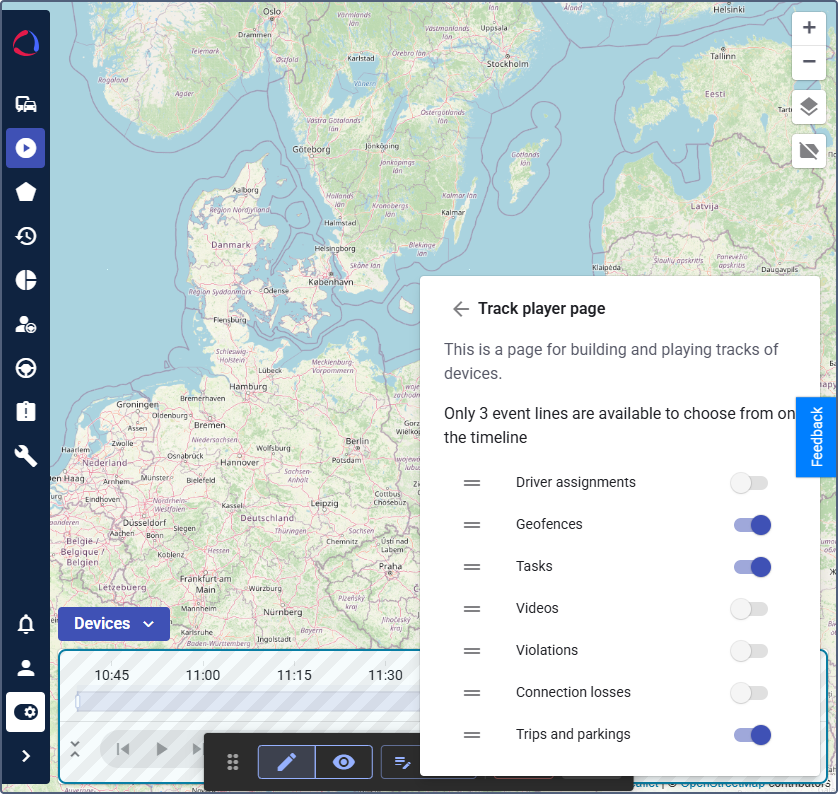

To configure the timeline in the track list:
  1. Log in to Wialon Platform FleetSpace.
  2. Open the Track Player page.
  3. Click the icon to enable the editor mode.
  4. Click on the section highlighted in blue.
  5. Select the event lines which should be displayed on the timeline. The following lines are available:
    Line Description
    Driver assignments Shows the intervals during which a driver was assigned to the vehicle.
    Geofences Shows the intervals during which the vehicle was within a geofence.
    Tasks Shows the intervals of events on the basis of which tasks were created.
    Videos Shows the intervals during which the vehicle cameras recorded videos.
    Violations Shows the intervals of violations.
    Connection losses Shows the intervals during which connection was lost.
    Trips and parkings Shows the intervals of trips and parkings.
  6. Change the line order if necessary.
  7. Click the icon .
