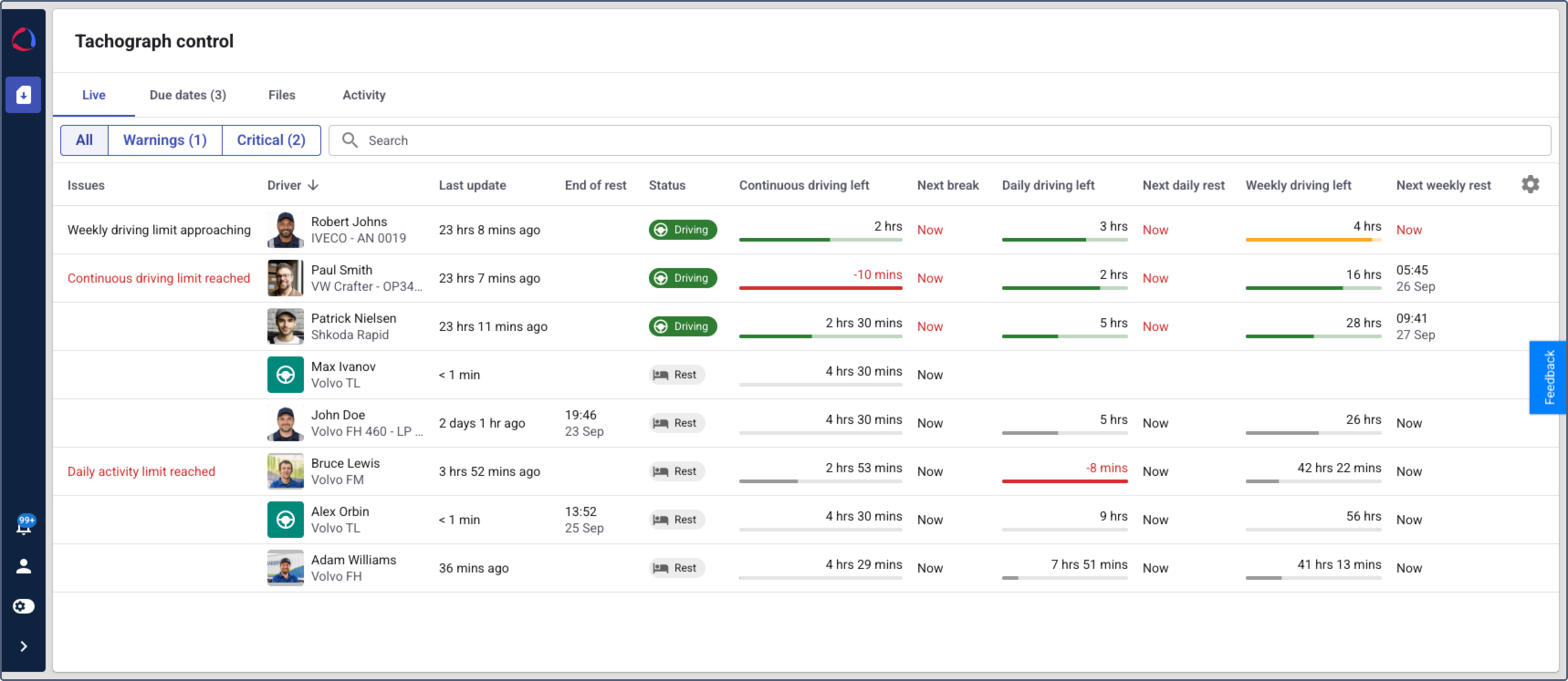

The Live tab on the Tachograph control page displays a table with real-time tachograph data for all your drivers. Use this table to monitor driver activity, track remaining driving times, and ensure compliance with EU 561/2006 driving and rest regulations.
“Live” table columns
Each row in the table represents a driver card currently inserted in a tachograph slot. A tachograph has two card slots, so a single device can show up to two rows if both slots have driver cards inserted.
The table contains the following columns:
Column Description
Issues The most severe active compliance issue for the driver, based on EU 561/2006 driving and rest regulations. Warning issues indicate that the driver is approaching a driving time limit. Critical issues are highlighted in red and indicate that the limit has been reached or exceeded. The column is empty when the driver has no active compliance issues. See Issue states for the full list of possible states.
Driver The name of the driver linked to the inserted driver card, with the device name displayed below it. If the card code doesn’t match any driver in the system, the raw card code is displayed instead. If the card code matches multiple drivers, all matching drivers are shown with overlapping avatars and comma-separated names. A green badge indicates an identified driver, while a red question mark badge indicates that the driver identity couldn’t be determined.
Last update The last time a tachograph message was received (for example, 1 day ago, 2 hrs ago).
End of rest The date and time when the driver’s rest period ends and work resumes. This column shows a value only when the status is Rest.
Status The current activity state of the driver as reported by the tachograph: Driving, Rest, Other work, Available, or Unknown (displayed when the tachograph hasn’t reported an activity state). The duration of the current activity is shown below the status label.
Continuous driving left A progress bar showing the remaining continuous driving time out of the 4.5-hour limit. The remaining time is displayed as a label next to the bar. This column is empty when the driver’s status is Rest.
Next break The date and time when the mandatory 45-minute break must start. Displays Now if the limit has been reached or exceeded, or if the driver is currently resting. Displayed in red if the rest is overdue and the driver is not resting.
Daily driving left A progress bar showing the remaining daily driving time out of the 9-hour limit (for example, 9 hrs). The remaining time is displayed as a label next to the bar. When the driver’s status is Rest, the bar is shown in a muted style.
Next daily rest The date and time when the daily rest must start. Displays Now if the limit has been reached or exceeded, or if the driver is currently resting. Displayed in red if the rest is overdue and the driver is not resting.
Weekly driving left A progress bar showing the remaining weekly driving time out of the 56-hour limit (for example, 56 hrs). The remaining time is displayed as a label next to the bar. When the driver’s status is Rest, the bar is shown in a muted style.
Next weekly rest The date and time when the weekly rest must start. Displays Now if the limit has been reached or exceeded, or if the driver is currently resting. Displayed in red if the rest is overdue and the driver is not resting.
Bi-weekly driving left A progress bar showing the remaining driving time out of the 90-hour limit for two consecutive weeks (the previous and the current week). The remaining time is displayed as a label next to the bar. No progress bar is shown if the device doesn’t send the cumulative driving time.
A dash (—) in a column indicates that no data is available (for example, the driver hasn’t started driving yet, or the device doesn’t provide this parameter).
The date format depends on when the event is expected: if it falls on the same day, only the time is shown (for example, 04:11). If it falls on a different day, the date and time are shown (for example, Jul 18, 04:11). Overdue deadlines are highlighted in red.

Issue states
The Issues column in the Live table displays a text when the tachograph detects that the driver is approaching or has exceeded a driving time limit defined by EU Regulation 561/2006. Each row shows at most one issue: the most severe active condition reported by the tachograph.
Issues are divided into two severity levels:
  • Warning: The driver is approaching a driving time limit (typically 15 minutes before the limit is reached).
  • Critical: The driver has reached or exceeded a driving time limit. Critical issues are highlighted in red.
The following table lists all issue states displayed in the Issues column:
Issue Severity Description
Continuous driving limit in 15 min Warning The driver is 15 minutes away from reaching the 4.5-hour continuous driving limit.
Continuous driving limit reached Critical The driver has reached the 4.5-hour continuous driving limit. A 45-minute break is required.
Daily driving limit in 15 min Warning The driver is 15 minutes away from reaching the 9-hour daily driving limit.
Daily driving limit reached Critical The driver has reached the 9-hour daily driving limit.
Daily activity limit in 15 min Warning The driver is 15 minutes away from reaching the 16-hour shift limit. The 16-hour shift limit counts the total time since the end of the last daily rest, including driving, other work, availability, and breaks.
Daily activity limit reached Critical The driver has reached the 16-hour shift limit. The 16-hour shift limit counts the total time since the end of the last daily rest, including driving, other work, availability, and breaks. A daily rest is required.
Weekly driving limit approaching Warning The driver is approaching the weekly driving time limit (56 hours).
Weekly driving limit exceeded Critical The driver has reached the weekly driving time limit (56 hours).
Bi-weekly driving limit approaching Warning The driver is approaching the two-week driving time limit (90 hours).
Bi-weekly driving limit exceeded Critical The driver has reached the two-week driving time limit (90 hours).
When the driver has no active compliance issues (normal state), the column is empty.

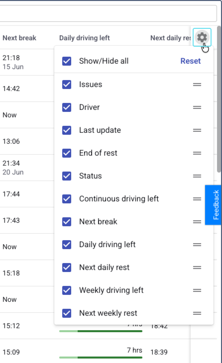

Customizing column visibility
You can choose which columns should be displayed in the table and change their order. To do this, click the icon gear icon in the upper-right corner of the table header.
In the configuration menu, you can:
  • Use the checkboxes to show or hide individual columns. Use the Show/Hide all checkbox to select or cancel the selection of all columns at once.
  • Drag the columns using the icon drag handle to reorder them.
  • Click Reset to restore the default column configuration.
The changes apply immediately to the table view.

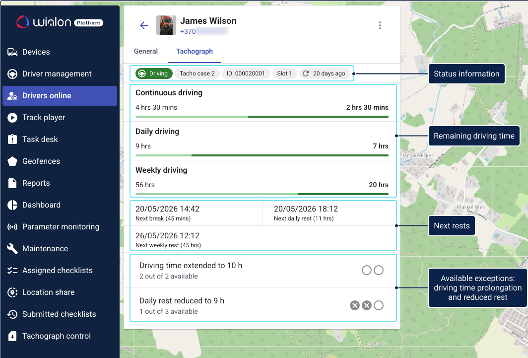

Viewing driver tachograph details
You can view detailed tachograph data for a specific driver by opening the driver details from either of the following locations:
  • On the Tachograph control page, click a driver row in the Live table.
  • On the Drivers online page, click a driver in the list.
The driver detail window contains two tabs:
  • General: displays the driver’s profile information and widgets configured for the driver details (for example, timeline, track player, device assignment, and so on). To customize the widgets on this tab, use the editor mode. To edit the driver’s profile information, go to the Driver management page.
  • Tachograph: displays detailed live tachograph data for the selected driver.
The Tachograph tab appears only when the Tachograph control module is enabled for the customer account.
Status information
At the top of the Tachograph tab, a set of chips provides a quick overview of the driver’s current tachograph state:
Chip Description
Status The current tachograph activity: Driving, Rest, Other work, or Available. The set of other chips shown below depends on the current status.
Device The name of the device from which the tachograph data is received.
Driver card code The identification code of the driver’s tachograph card.
Card slot The tachograph slot number (1 or 2) where the driver card is inserted.
Last update The time when the last tachograph message was received.
Remaining driving time
The Remaining driving time section displays progress bars that show how much driving time the driver has left within each limit defined by EU Regulation 561/2006:
Indicator Description
Continuous driving Remaining continuous driving time out of the 4.5-hour limit.
Daily driving Remaining daily driving time out of the 9-hour limit.
Weekly driving Remaining weekly driving time out of the 56-hour limit.
Bi-weekly driving Remaining driving time out of the 90-hour limit for the previous and the current week. The row isn’t shown if the device doesn’t send the cumulative driving time.
The color of each progress bar changes as the remaining time decreases: green (sufficient time), yellow (approaching the limit), red (limit reached or exceeded).
Next rests
This section displays the date and time of each upcoming required rest:
Rest type Required duration
Next break 45 minutes
Next daily rest 11 hours
Next weekly rest 45 hours
If the tachograph doesn’t provide data for a particular rest type, a placeholder is shown instead.
Weekly exceptions
EU Regulation 561/2006 sets standard daily driving and rest limits but allows drivers to deviate from them a limited number of times per week. This section shows how many times the driver can extend daily driving time and reduce daily rest for the current week.
Each exception is shown as a set of circle icons. Filled circles represent used times, and empty circles represent remaining ones.
Indicator Maximum per week Description
Driving time extended to 10 h 2 The number of remaining times when daily driving time can be extended from 9 to 10 hours.
Daily rest reduced to 9 h 3 The number of remaining times when daily rest can be reduced from 11 to 9 hours. This number resets after each weekly rest. For example, if a driver takes a weekly rest on Sunday, they can use up to 3 reduced daily rests (9 hours instead of 11) during the following work week before the next weekly rest.
