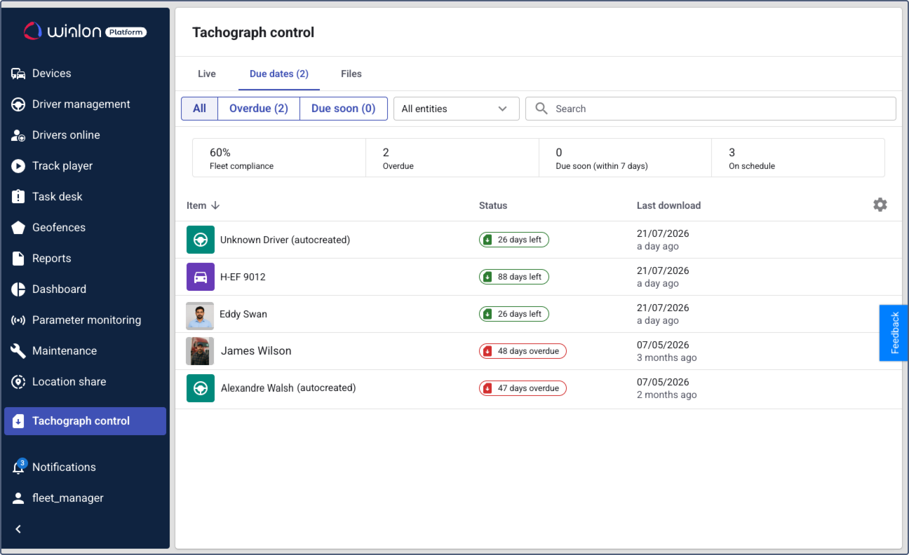

“Due dates” tab
The Due dates tab on the Tachograph control page shows the download deadline status for every driver and device that has at least one tachograph file download.
Due dates tab with the summary section and the table
The number in parentheses next to the tab name (for example, Due dates (2)) shows the total number of overdue and due soon items.

Due dates table
Each row in the table represents a driver or device with a tachograph download. The table contains the following columns:
Column Description
Name The name of the driver or device. Click a row to open the driver or device details.
Status The download deadline status, shown as a color-coded chip. See Status indicators for details.
Last download The date of the last tachograph file download for this driver or device.
Status indicators
The Status column displays a color-coded chip that shows how close the driver or device is to their download deadline:
Indicator Color Status Description
Green On schedule More than 7 days remain until the download deadline. The chip displays the number of days left (for example, 27 days left).
Yellow Due soon 7 days or fewer remain until the download deadline. The chip displays the number of days left (for example, 3 days left). When the deadline is today, the chip displays Due today.
Red Overdue The download deadline has passed. The chip displays the number of days overdue (for example, 47 days overdue).

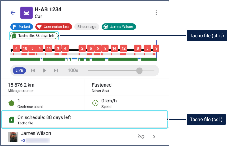

Deadline widgets in device and driver lists
In addition to the Due dates tab, you can add tacho file deadline widgets to the device and driver lists and details in FleetSpace. These widgets display the download deadline status directly on the Devices and Drivers online pages, so you don’t need to open the Due dates tab to check individual deadlines.
The following widgets are available:
Widget Description
Tacho file (chip) A chip that shows the download deadline status with a color-coded indicator next to the driver or device name.
Tacho file (cell) A cell that shows the download deadline status in the parameters grid.
tacho file chip and cell in device details
The widgets use the same color coding as the Due dates table: green (on schedule), yellow (due soon), and red (overdue). If no tachograph file has been downloaded for the driver or device yet, the widget shows the overdue status.
To add these widgets, use the editor mode. For instructions on adding widgets to the device list and details, see Setting up widgets in the device list and Setting up widgets in the device details. For the driver list and details, see Customizing a driver profile view.

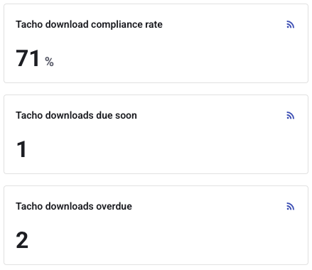

“File compliance” dashboard widget
The File compliance (value card) widget shows one summary value on the Dashboard.

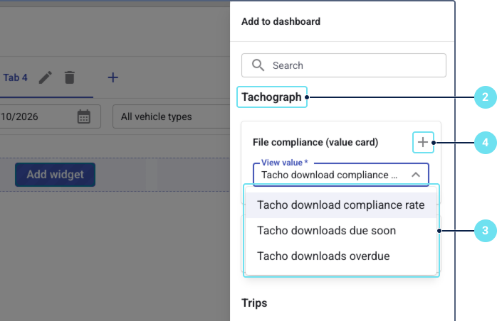

To add it:
  1. Enable the editor mode on the Dashboard page and click Add widget.
  2. In the Add to dashboard panel, find the File compliance (value card) widget in the Tachograph section. You can also use the search.
    File compliance widget in the Add to dashboard panel
  3. In the View value dropdown, select the value the widget shows:
    View value Description
    Tacho download compliance rate The percentage of drivers and devices whose downloads are on schedule.
    Tacho downloads due soon The number of drivers and devices with 7 days or fewer left until the deadline.
    Tacho downloads overdue The number of drivers and devices whose deadline has passed.
  4. Click the icon next to the widget name.
To show several values at the same time, add the widget for each of them.

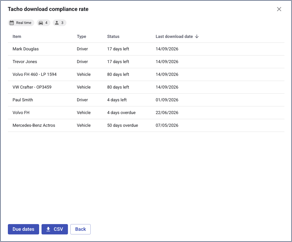

Viewing the details
Click the widget to see the drivers and devices behind the value.
File compliance widget details
The chips at the top show that the data is real time and how many devices and drivers are in the list. The table contains the following columns:
Column Description
Item The name of the driver or device.
Type Whether the item is a driver or a vehicle.
Status The download deadline status. See Status indicators.
Last download date The date of the last tachograph file download.
Drivers are displayed in the list only if the Drivers module is enabled for the customer account and you have the Read permission on drivers.
You can sort the data by clicking a column header and download it in CSV format. To filter or search the data, click Due dates to go to the tab.
