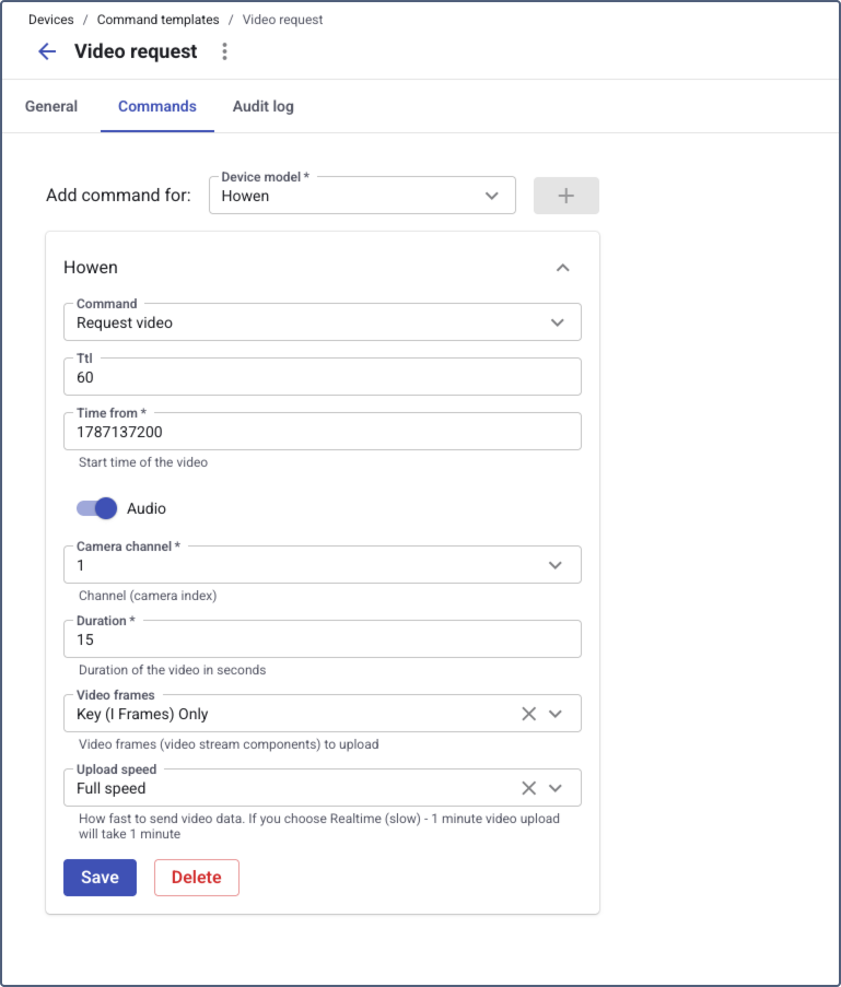

  2. On the Commands tab, select the device model and click the icon plus icon.
  3. Select the command based on the required action. For example, depending on the specific device, the following commands can be available:
    • Take photo: Requests a photo from a selected camera channel at the moment the command is executed.
    • Start video stream: Starts a live stream from a selected camera channel.
    • Request video: Downloads a video clip for a specified time and duration from a selected camera channel.
    • Playback video: Streams previously recorded video with playback controls.
  4. Configure the default parameter values for the command. These values are pre-filled when a user executes the command. You can leave them empty, and then users set them manually. The following parameters are the most common ones:
    Parameter Description
    channel The camera number. Each camera of the device has its own channel number. See the device manufacturer documentation to find out which number corresponds to which camera.
    from The start time of the requested video.
    duration The length of the requested video.
  5. If you have different device models with video functionality, add a command for other devices to the same template repeating steps 2-4. One command template can contain similar commands for different types of devices, for example, the Request video commands with their own settings for Howen and Streamax devices.
  6. Click Save to create the command template.
