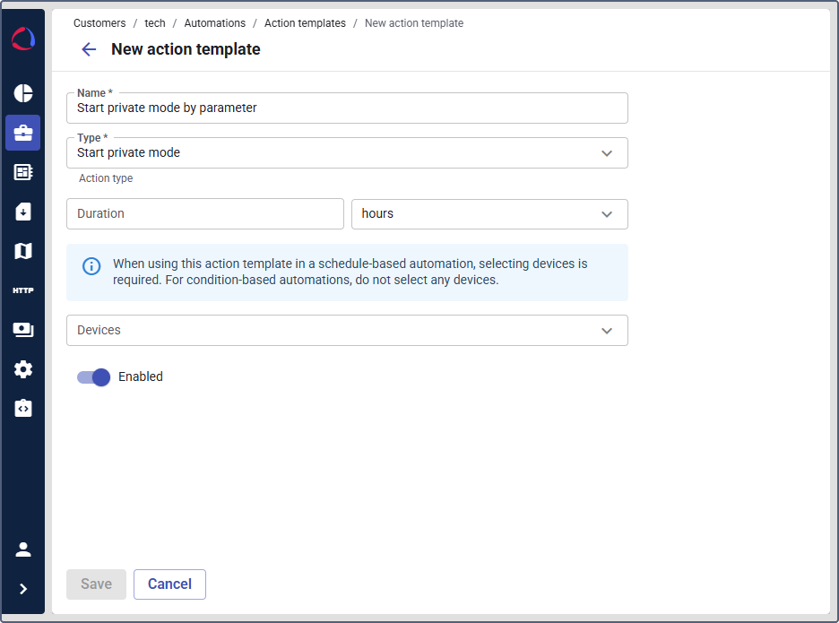

Step 1: Create a “Start private mode” action template
First, create an action template that will turn on the private use for the selected vehicles:
  1. In Wialon Platform Studio, navigate to the Customers page.
  2. Select a customer from the list to open their details.
  3. Go to the Automations tab.
  4. Switch to the Action templates mode.
  5. Click New action template.
  6. In the Name field, enter a name, for example, Start private mode by parameter.
  7. In the Type field, select Start private mode.
    Start private mode by parameter action
  8. (Optional): In the Duration field, specify how long private mode must stay enabled. Select either hours or minutes in the right field and enter the value (up to 720 hours or 43200 minutes). Private mode will be automatically disabled after this period. Otherwise, you can configure the End private mode action to disable private mode based on conditions different from the time period.
  9. Make sure the action template is Enabled.
  10. Click Save.

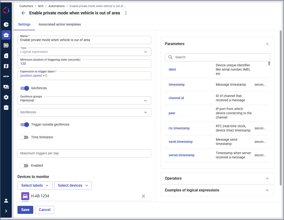

Step 2: Create an automation with a logical expression
To create a condition that acts as a trigger for the action template, follow the next steps:
  1. In the customer Automations tab, click New automation.
  2. In the Name field, enter a name, for example, Enable private mode when vehicle is out of area.
  3. In the Automation type field, select Logical expression.
    logical expression to control motion in the unauthorized area
  4. In the Minimum duration of alarm state field, specify how long the condition must remain true before the automation is triggered (in seconds). This helps avoid false triggers from short fluctuations. For example, 120.
  5. In the Expression to trigger alarm field, enter an expression based on the parameters your device sends to signal motion, for example position.speed > 0.
  6. Toggle on and configure the Geofence option:
    • Select geofence groups or separate geofences that you consider as an authorized area.
    • Enable the Trigger outside geofences option.
      Thus the automation is triggered only when the vehicle is outside the selected geofences (when it leaves the authorized area).
  7. (Optional): In the Maximum triggers per day field, enter the maximum number of times the automation should trigger.
  8. Enable the automation.
  9. In Devices to monitor, select the devices or labels, or both, to which this automation applies.
Before saving the automation workflow, it is necessary to associate it with the created action template.

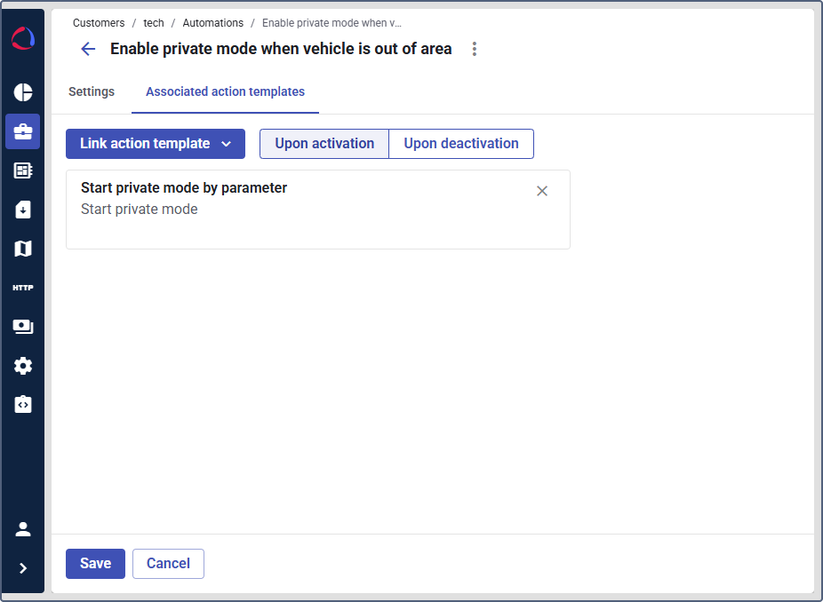

Step 3: Link the automation to the action template
To finish the automation workflow:
  1. In your automation, go to the Associated action templates tab.
    associated actions template
  2. Click Link action template.
  3. Select the Start private mode action template you created.
  4. Click Save.
When the device starts sending telemetry that matches the logical expression, Wialon Platform triggers the Start private mode action template and enables private mode. While private mode is active, GPS-dependent data is not registered and can’t be restored (see Enabling private use mode for a device).
