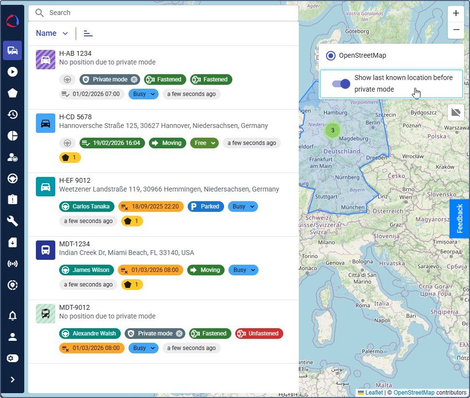

When a device is in private use mode, its position data is hidden to ensure privacy. However, you can still view its private use status in various sections of Wialon Platform FleetSpace.
On device and driver lists or detail pages
When a device is in private use mode, its status is visually indicated in the Devices tab, Drivers online page, or on the individual device and driver detail pages (depending on your workspace configuration).
  • Striped icon: Both the device icon and the driver icon (if a driver is assigned to that device) appear striped.
  • Private use (chip) widget: If the Private use (chip) widget is added to your workspace, it will appear on the list row or on the details page, indicating the active private mode.
On the map
When a device is in private use, its real-time location is not displayed on the map. Instead, you can view only the device last known position before private mode was activated. For that, click on the icon icon consisting of two stacked layers on the right side on the map and enable the Show last known position before private mode toggle.
