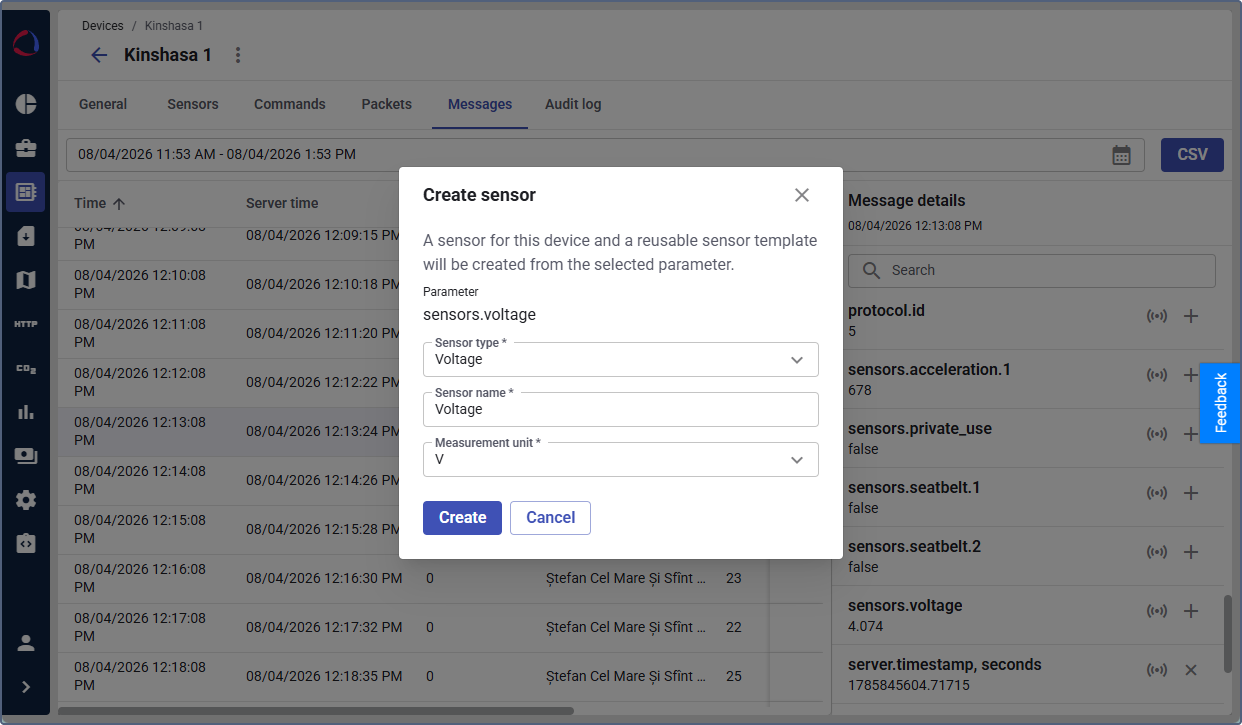

Set how to create a sensor from message parameters on the page Viewing device data.
Creating and configuring a sensor template
Sensor templates are reusable configurations that ensure consistency across multiple devices of the same model. You can either use an existing template or create a new one.
