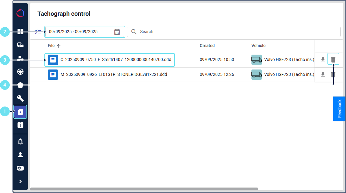

To delete files from the Tachograph control page, follow the steps below.
  1. In the sidebar, select the Tachograph control page.
  1. Specify the time interval for which you want to receive the file list.
  2. Find the file you want to delete in the list. You can search the files by name, device, and driver.
  3. Delete the file using the delete icon at the end of the file row.

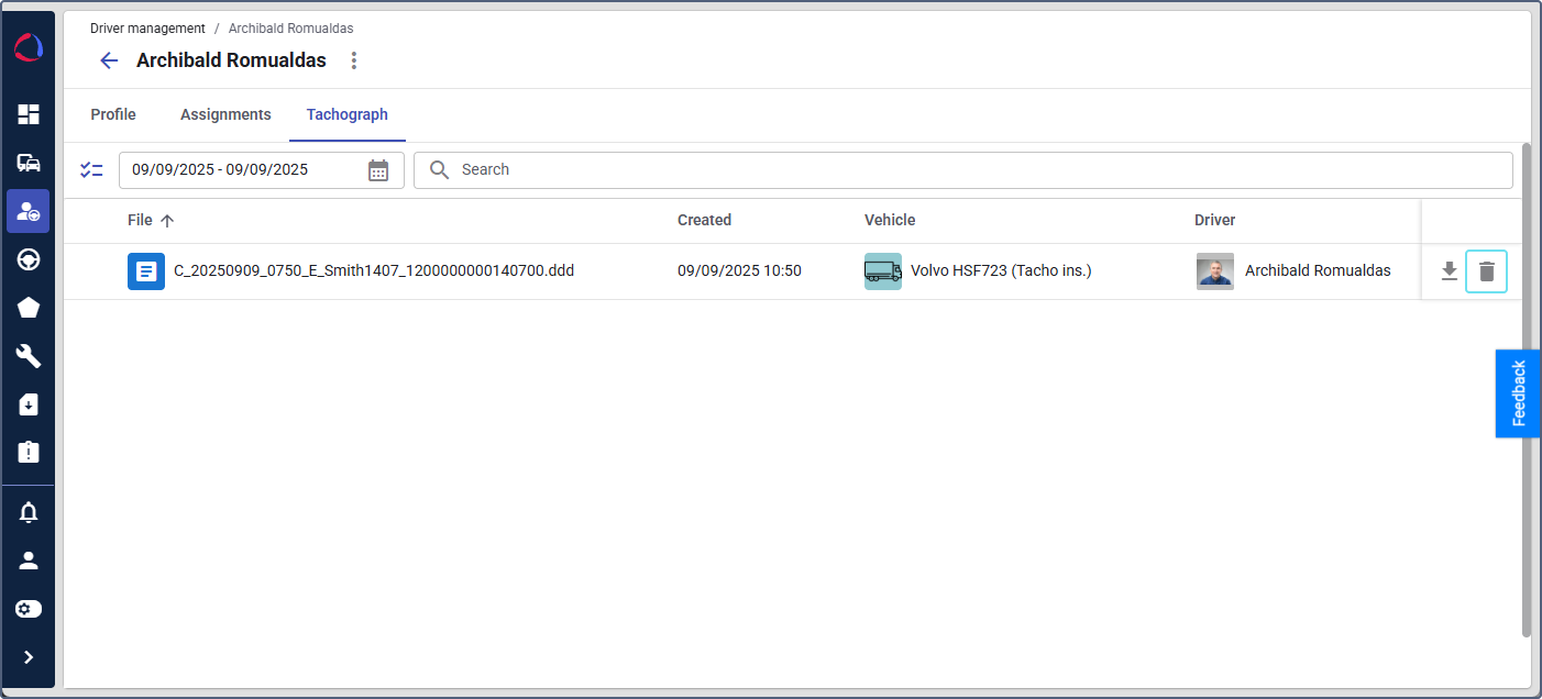

To download files from the Drivers tab, follow the steps below.
  1. In the sidebar, select the Driver management page.
  2. Click on the row of the required driver in the list. You can search drivers by name, phone number, and device.
  3. Navigate to the Tachograph tab of the driver details.
  4. Specify the time interval for which you want to receive the file list.
  5. Delete the required file using the delete icon at the end of the file row.
