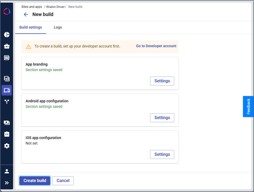

  1. On the Build settings tab of the build details, verify that the App branding and at least one app configuration section (Android app configuration, iOS app configuration, or both) show a configured status.
  2. Click Create build.
  3. The system starts generating the app binaries for both Android and iOS. The build process runs in the background, and you can navigate away from the page.

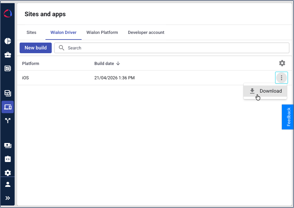

To download a completed build:
  1. Navigate to the Driver app or FleetSpace app tab on the Sites and apps page.
  2. Find the build with the Completed status.
  3. Click the action menu icon three vertical points icon and select Download.
  4. The system downloads the build file:
    • AAB for Android builds
    • IPA for iOS builds
