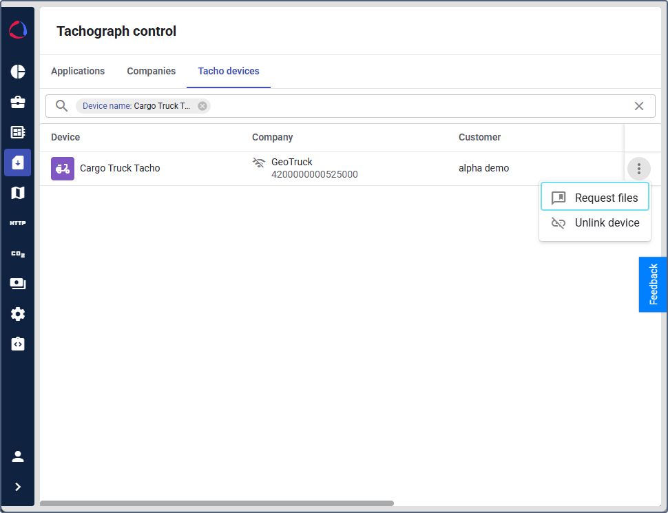

To request files from a device:
In Wialon Platform Studio, expand the Connectivity section in the navigation menu.
Open the Tachograph control page.
Navigate to the Tacho devices tab.
Find the required device in the list. You can search devices by name, company name, company card, company connection status, customer, and device connection status.
At the end of the row with the required device, click the three-point icon.
Select Request files.
Select the slot type which should be used to retrieve the file. You can select multiple slots.
The slot types you select here apply only to this request. They don’t change the slot types configured for the automatic file request of this device.
Click Send.
