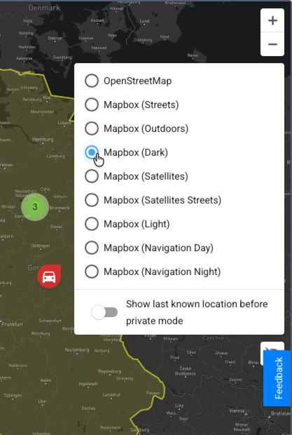

  3. On the map, click on the icon a stack of papers icon which is located in the upper-right corner.
  4. Select a map service from the list. The list includes available basemaps (including layers) and overlays if any are added. You can select one basemap at a time and add multiple overlays on top of it.
    A settings menu overlaid on a map, with a cursor selecting the 'Mapbox (Dark)' radio button from a list of different map styles.
After selection, the map is instantly updated.
