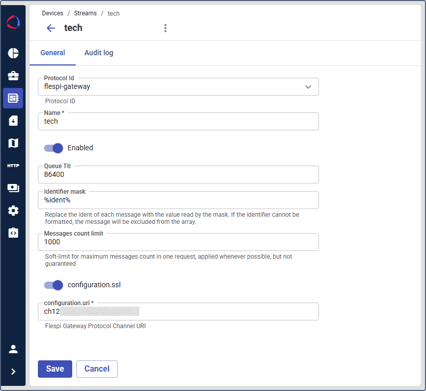

  4. On the General tab, fill in the stream parameters.
Configuring a stream
  1. From the Protocol Id dropdown list, select the protocol of the receiving system. This determines the format of the data being sent. See the list of available protocols in flespi documentation.
  2. In the Name field, enter a unique, descriptive name to identify the stream. This is a mandatory field.
  3. Make sure the Enabled toggle is active if you want the stream to start sending data immediately after saving.
  4. Depending on the protocol, you might need to fill in the data required for this protocol, such as messages limit, URI and configuration details. Follow the instructions under the appropriate field.
  5. Set the Queue Ttl (time to live) in seconds. This value, in seconds, defines how long a message will be stored if it can’t be delivered. After this time, the message is discarded.
  6. (Optional): configure the Identifiers mask. This template formats the device ID before it’s sent. You can use the %ident% placeholder, which represents the original device ID, to create a custom identifier required by the receiving system.
  7. Make sure the Enabled toggle is active if you want the stream to start sending data immediately after saving.
  8. Click Save.

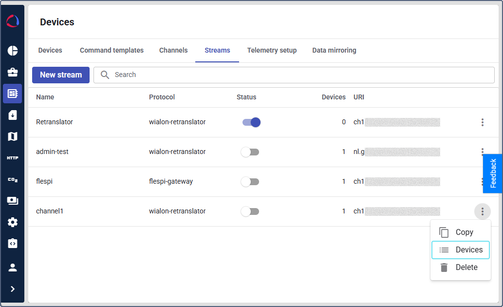

Adding devices to a stream
To link devices to a stream so their data is sent to the configured destination:
  1. On the Streams tab, find the required stream in the list.
  2. Click the icon in the stream row to open the context menu.
  3. Select Devices.
  4. In the device list, select the devices you want to stream.
  5. Click Save.
The selected devices appear in the Devices column of the stream list. To view all linked devices, hover over the device chip in the column.

The Streams tab displays a list of all configured streams with their name, protocol, status, and the number of devices currently sending data through them.
From this list, you can:
  • Copy the stream URI: Hover over the URI name and click the icon .
  • View the number of assigned devices: Hover over the number of devices in the Devices column to see the full device list in a tooltip.
  • Enable or disable a stream: Use the toggle switch in the Status column to start or stop the data flow without deleting the configuration.
  • Edit a stream: Click on a stream’s row to open its settings and make changes.
  • Delete a stream: Open the stream’s settings and use the delete option.
