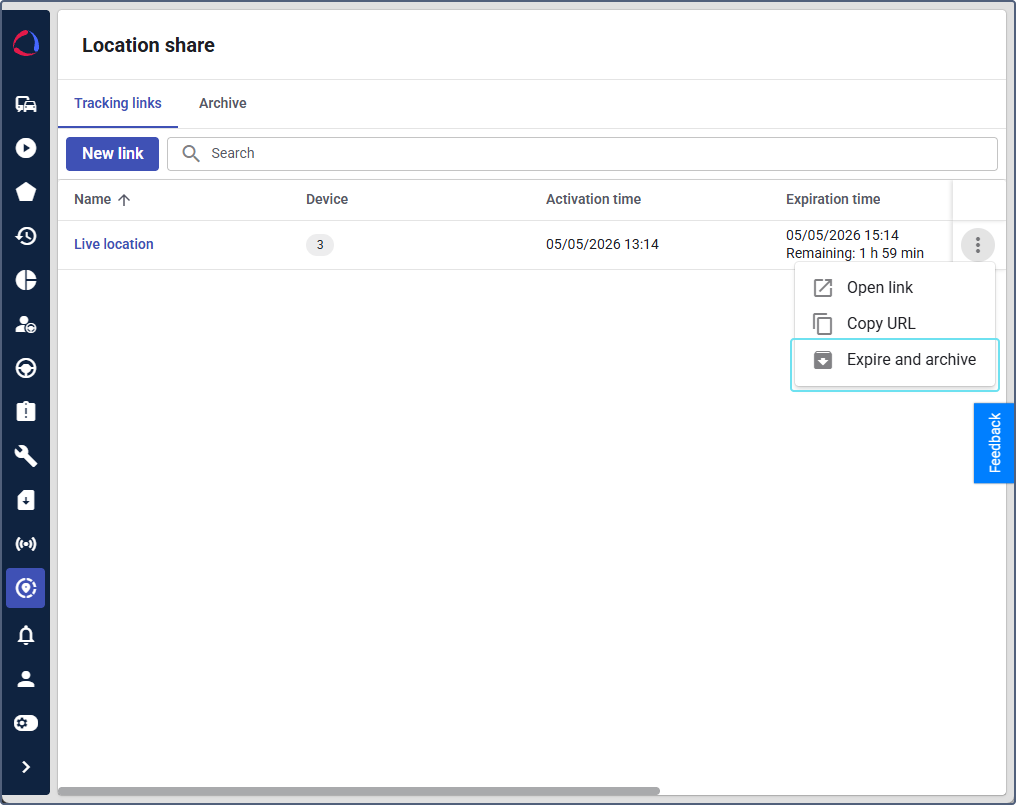

If an active link is no longer needed, you can move it to the archive manually before its expiration time. To do this, follow the steps below.
  1. In Wialon Platform FleetSpace, select the Location share page in the sidebar.
  2. Find the required link in the list. You can use search by link name or vehicle name.
  3. At the end of the link row, click the icon .
  4. Select Expire and archive.
After that, the link becomes inactive and is no longer shown in the Tracking links list. It is now considered expired and is displayed on the Archive tab.
