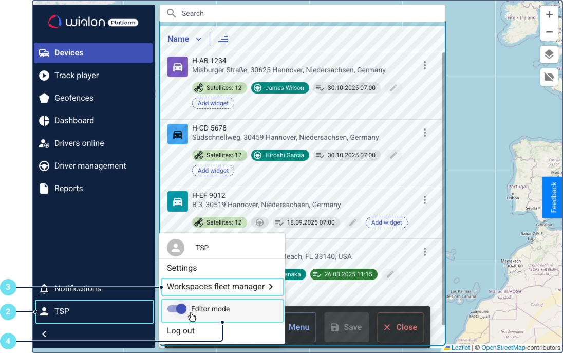

  1. Log in to Wialon Platform FleetSpace as customer for configuration proposes.
  2. Click on the service provider name in the left bottom corner.
  3. Ensure the required workspace is selected. If you need to create a new workspace, see the guide on creating a new workspace.

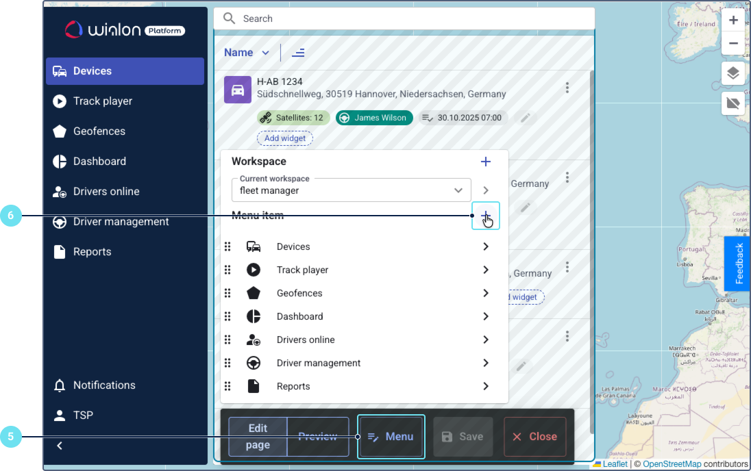

  4. Click the icon in the sidebar to enable the editor mode.
  5. If the sidebar is collapsed, expand it using the icon .
  6. Click New page.

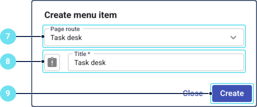

  7. In the Source page field, select Task desk.
  8. Modify the icon and name of the page if needed.
  9. Click Save.

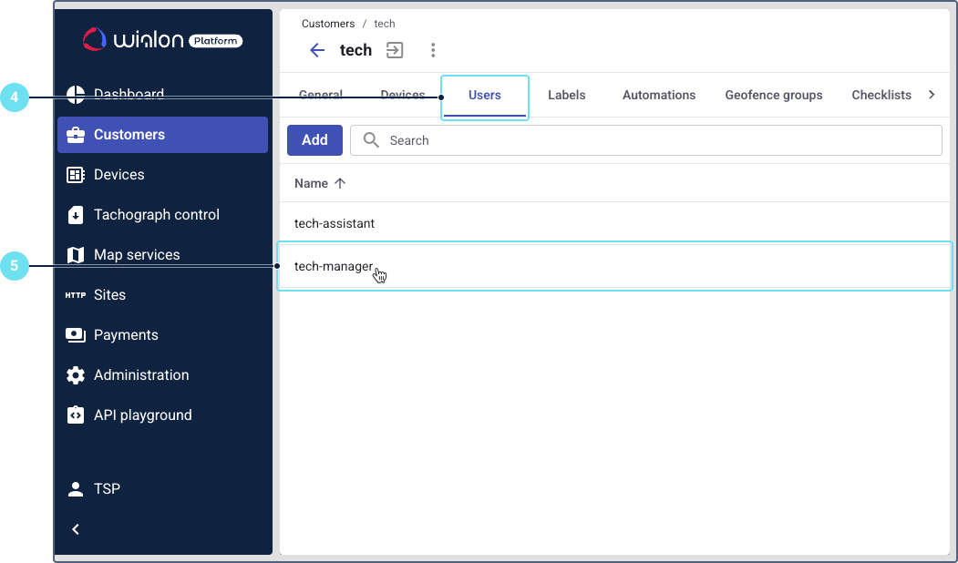

  1. Log in to Wialon Platform Studio.
  2. Navigate to the Customers page from the main menu.
  3. Select the relevant customer from the list.
  4. Go to the Users tab within the customer’s details.
  5. Click on the user’s row to open their details.

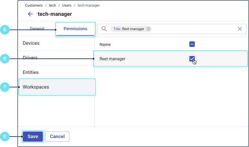

  6. Go to the Permissions tab.
  7. Click on the Workspaces section.
  8. Ensure that the workspace you configured in Wialon Platform FleetSpace is selected for this user.
  9. Click Save to apply any changes to the user’s permissions.
