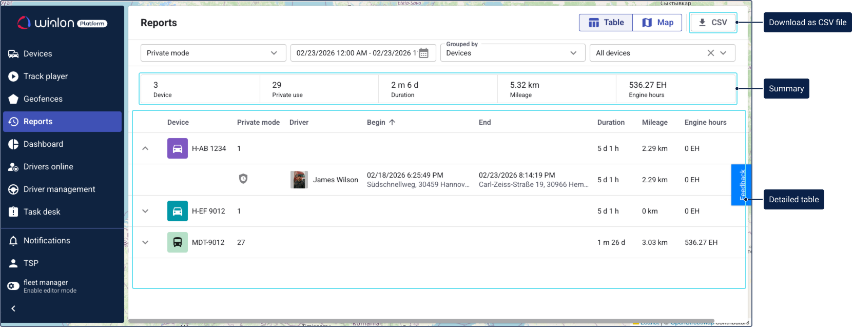

Report results
The report is organized into two sections: a summary at the top and a detailed table below.
Summary
The summary section provides the following key statistics:
  • The total number of devices or drivers included in the report.
  • The total number of private use intervals (time periods when the private use was enabled).
  • The total duration of private use intervals.
  • The total mileage covered during all private use intervals.
  • The total engine hours accumulated during all private use intervals.
The detailed table provides specific information for each private use interval. You can sort the columns by clicking on their headers.
Detailed report table
  • Device: The name of the device used during the private use interval.
  • Driver: The driver assigned to the device.
  • Private mode: The total number of private use intervals for that device or driver.
  • Begin: The start time and address of the private use interval.
  • End: The end time and address of the private use interval.
  • Duration: The duration of a private use interval. For the summary row, it shows the combined duration of all private use intervals for a device or driver.
  • Mileage: The distance covered during the private use interval. For the summary row, it shows the total mileage for that device or driver. If data is not available, “N/A” is displayed.
  • Engine hours: The duration the engine was running during the private use interval. For the summary row, it shows the total engine hours for that device or driver. If data is not available, “N/A” is displayed.
You can expand each row by clicking the icon icon of downward-facing arrow to view a list of individual private use intervals for that vehicle or driver.
Exporting the report
You can export the report data to a CSV file for further analysis by clicking the icon icon of a downward-pointing arrow with a horizontal line below it at the top of the report table.
