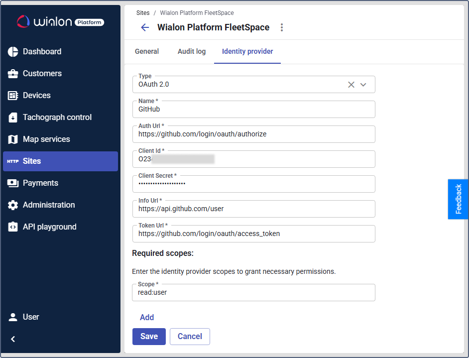

Step 1: Configure the identity provider
This step is for the service providers and administrators to set up the identity provider within Wialon Platform Studio.
  1. In Wialon Platform Studio, go to the Sites and apps page in the sidebar.
  2. Select the site you want to configure by clicking on its name in the list.
  3. In the site settings, open the Identity provider tab.
  4. In the Type field, select Open ID or OAuth 2.0.
  5. Fill in the required fields with the credentials provided by the service chosen as the identity provider:
    • Name
    • Client ID
    • Client Secret
    • Auth Url
    • Info Url
    • Token Url
  6. For OAuth 2.0, in the Required scopes field, define the scopes your site requests from the identity provider. Enter only the scopes necessary to identify the user. For example, if you are using GitHub as your identity provider, enter read:user to allow your application to read your GitHub public profile, or public_profile scope for connecting via Facebook. Consult the identity provider documentation to find the correct, specific scopes required for identification.
    To add a new scope, click Add. To delete a scope, click .
